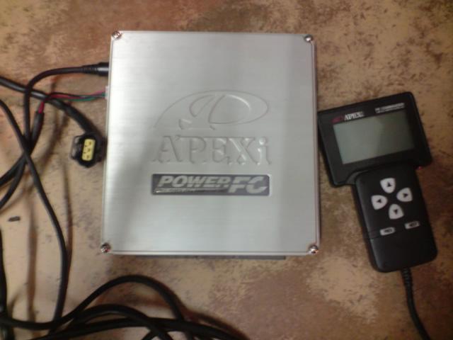

Hi,need help from sifu here.
My fren got 1 power fc take from japan by his fren.n he oledi check all socket is for mitsubishi.
1)can it pnp to his 4g63?(but he told me his engine not evo model,is rvr model)
2)if cant pnp,after install it n do some tuning then ok right?how much for tuning tis?
3)socket(yellow colour) at left hand side is wat for?
Thanks for ur time,sifu

power fc will have code will tell you what car it used for
just see the code and you will know it for what car

yes, most Power FC is pnp (plug and play) to the car (they make specific harness / plug) for the car ECU.
HOWEVER, I have one my guy done a Honda Power FC into a freaking SkylineR33 before. It's doable. So, suggestion is for you to find out the part # of the Powe FC (usually goes like 414-M904) then decide what you need to do. What year/spec is your car ?
Here is a list of part # for power fc and the year it is use for
Apexi-USA - Power FC
If you can't find a match here, I also have a master catalog from APEX listing all the power FC and car model. Just post here the part # and I can tell you which car and what year.

Bro,my fren cant found any code like 414-M904,but he found PFC SW20 A0013,is it for Toyota MR2?his car is perdana with RVR N23W 4g63.thanks

Apexi PowerFC is a "standalone" engine management system. It is designed to completely replace your existing ECU and allow you to program it - to "tune" the various aspects of the engine and others. As a standalone, it will also take control of your AC, lights, diagnostics, etc. besides taking control of ignition and fuel injection.
As for the improvements, it depends on the tuner and your goals. In some applications, we will tune our calls to the point where a piggy back or standalone EMS is required to get the most out of our settings - because the stock ECU was not designed for it. For example, trying to hit 1200HP with a massive turbo. The stock ECU is not designed to do this and so we must exceed its capabilities.
Piggy back EMS is Apexi SAFC and Apexi VAFC (for Vtech). It is capable of adjusting your fuel maps to exceed the stock ECU capability and sticks "on top" of your existing ECU - hence the term piggy back. It does not replace your stock ECU.
Do note that Japan Apexu is no longer supplying PowerFC for the older model of cars but you can find some of them from USA.
There are several types of PowerFC:
Standard
Called: LJetro or just normal PowerFC
Input Type: Airflow meter (AFM)
Extra: normal unit
Djetro
Called: Map Sensor PowerFC
Input Type: Map Sensor
Extra: normal unit with map sensor input instead of AFM
Pro
Called: FC Pro - PowerFC Pro
Input Type: AFM
Extra: Launch control (0km/h limiter) & Spark cut (instead of fuel cut) at limiter
AP Engineering
Called: AP Eng
Input Type: AFM
Extra: usually these are remapped PFC's to suit extra cars (ie R33 RB25 GTST PFC remapped to suit R32 RB20 PFC)

Bro,how to differentiate wat type is it?my fren got 1 is for toyota 3sgte,can mod it to use it to mitsubishi 4g63 or toyota 4age?thanks
