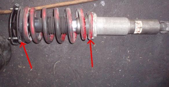

<blockquote data-quote="adian" data-source="post: 4401154" data-attributes="member: 690"><p>Firstly, what kind of sound is it? And it only happens when you are driving slowly?</p><p></p><p>A few things your mechanic should try doing, simply ones:</p><p>1. Tighten all the 3 top mount nuts that bolt the suspension to the top mount. Dont be surprised, this is all it could be. It is a very common occurance with double-wishbone suspension damper topmounts because they are engineered differently due to their non-load bearing design.</p><p>2. Jack up the car, try shake the tyre left and right and check for freeplay and sound. If there's a sound and freeplay, might be your steering rack rod and bearing. These need to be changed.</p><p>3. Also with the car jacked up, check for other freeplay. Kicked the tyres. If there is sound and movement, then it's your bushings, which would need to be replaced.</p></blockquote><p></p>
