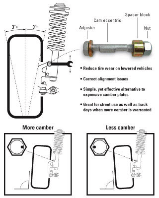

camber is adjusted via a bolt and nut which is holding your suspension shocks , here is the picture
i adjust camber on my own , and there will no reason to give way unless you run a "cheap nut and bolt" , "nut and bolt which is loose"
