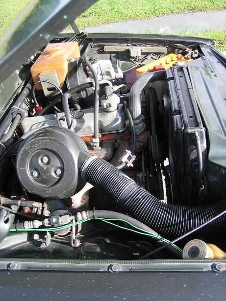

nitrus said:iswara's stock airbox sucks hot air like shit weih ... the mouth opening of the airbox is right above the extractor cover's "hole" .. and the fan right in front .... blowing hot air right into the airbox's opening ....
solution for CAI on stock airbox...nitrus said:if im not wrong ar i think the iswara UK specs had the "CAI" hose thing leading to the side of the headlamps there .... but still there is a small hose from the extractor cover lead to the airbox ...

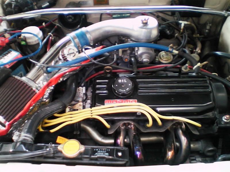

By right the EFI would autodetect the air level and compensate the fuel mixture. If your on carby like me, then your probably running lean if after your installation you didnt tune the carb.weikhee86 said:darn, i think better change back to stock airbox...my friend said after change airbox need to retune engine again...cos the rate of air intake is different now..is that correct?
