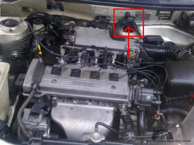

Need help advice from all the sifu, what is part name and function of the part as per picture attachment.
Now my car going to vibrate when i on the aircon. Is it that part can cause of it?
Do anyone know the cost for this of new part?
Thanks for advice.....

U may check either idle valve or FICD。
That is FICD, for stable idle after on aircond, can be adjust with allen key. Check got clog or not.
