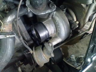

<blockquote data-quote="8229" data-source="post: 4045332" data-attributes="member: 59561"><p>its happen to me after i hit a pajero, after repair the front panel, change radiator, bonet, hit the road again, but no boost in, its like a n/a car, then found the actuator was bend like yours picture, change the actuator then its ok.... better get other actuator...</p></blockquote><p></p>
[QUOTE="8229, post: 4045332, member: 59561"] its happen to me after i hit a pajero, after repair the front panel, change radiator, bonet, hit the road again, but no boost in, its like a n/a car, then found the actuator was bend like yours picture, change the actuator then its ok.... better get other actuator... [/QUOTE]
