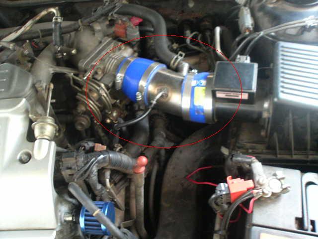

<blockquote data-quote="ctk22" data-source="post: 1063998693" data-attributes="member: 22529"><p>I used to have similar problem, due to a leakage at the air-filter box, where the vacuum hose connects to the air-box. In my case, the vacuum hose connector (PVC one) cracked, probably due to the mechanic accidentally pressed on it when servicing my air-cond. Can try check vacuum hose leakage too.</p><p></p><p>Hope this helps</p></blockquote><p></p>
