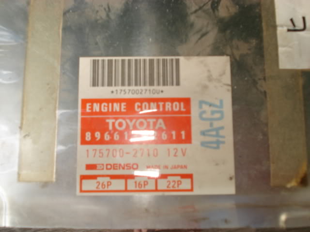

<blockquote data-quote="cuscostrutbrace" data-source="post: 1498433" data-attributes="member: 3867"><p>Yes ECU can blow but it is a rare cases,the ecu is high tech.First of all,look for the causes,why the ECU blow,is there any short circuit in the wiring,or electrical overload...No point you buy new ECU and then it blow again.</p><p></p><p>1.Yes you can find ECU at chop shop</p><p>2.I dont have</p><p>3.No other ECU can replace unless you change the system,or the socket,or </p><p>anything else that is associated with the engine system.</p><p>4.E manage is a piggy back ECU and it needs the original ECU to operate.</p></blockquote><p></p>
[QUOTE="cuscostrutbrace, post: 1498433, member: 3867"] Yes ECU can blow but it is a rare cases,the ecu is high tech.First of all,look for the causes,why the ECU blow,is there any short circuit in the wiring,or electrical overload...No point you buy new ECU and then it blow again. 1.Yes you can find ECU at chop shop 2.I dont have 3.No other ECU can replace unless you change the system,or the socket,or anything else that is associated with the engine system. 4.E manage is a piggy back ECU and it needs the original ECU to operate. [/QUOTE]
