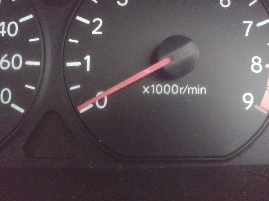

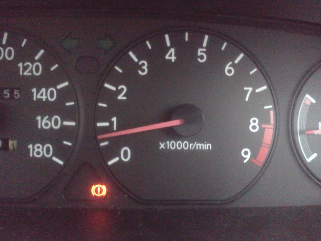

It's been a long time that my engine running at low idle speed. It's not a problem before, but recently I can feel the engine shaking at idle.
So how am i gonna increase the idle speed?
From the picture, I think my engine idle not more than 800 rpm.
It's irritating when the engine shake while the injector cycle from rich to lean (it shake when at lean condition).

Short term solution: increase engine idle speed
However I think there may be an underlying problem. Your temp gauge looks a bit on the high side. Last time my 4AGZE has idling problems too...turns out the radiator fan relay is spoilt and one day my engine just siezed because overheat. Now my fan is always on (jumped the relay contacts) and no idling problems so far.
Try using coolant in your radiator and use thicker oil (20W-50).
Also try cleaning throttle body. This shud be the easiest step.
