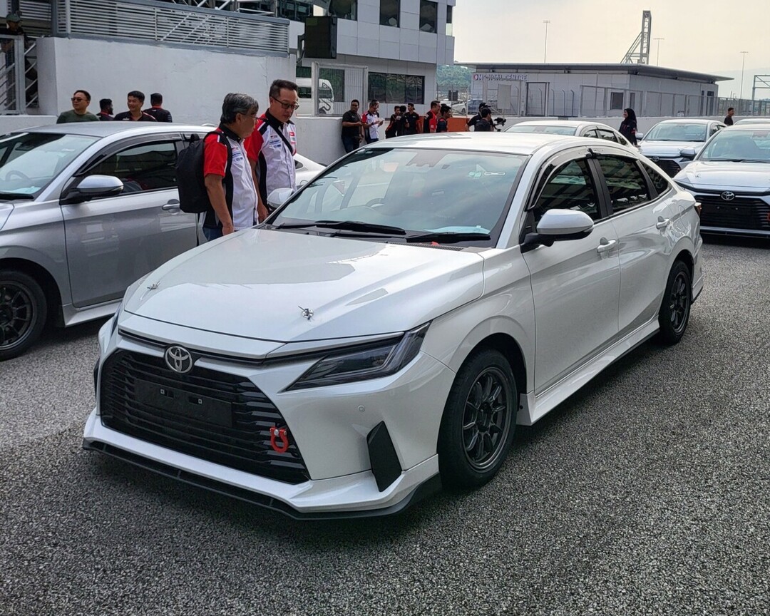

A breathtaking first glimpse indeed, to be introduced to the next gen, again race prepped version of the outgoing NGC100 Vios in full cup car form. Replacing the previous and very close to heart NCP151 TGR Vios that's been with us for the past 5 seasons.
How they are born: TGR Vios cup cars
About 30 units of these dealer stock sourced Vios donor cars go through an elaborate race conversion at Wing Hin Motorsports, the race engineering & technical arm of TGR Malaysia, where they are stripped down to bare necessities, a roll cage gets bolted in along with fire fighting system, auxiliary switches.
Then in go amenities like the bucket seat, 350mm steering wheel and safety harness, all OMP. Mechanical upgrades to powertrain, drivetrain and suspension are all part of the checklist.
Size and Chassis
This all-new 2024 NGC100 TGR Vios is visibly and physically bigger than the NCP151 predecessor (2019 - 2023) and more importantly, comes with significant changes in chassis geometry with a 70mm longer wheelbase, specifically:

Manual Transformation
The manual aspect of the new TGR Vios racecar need some mentioning.
Firstly the shifter feels obviously short, tight and direct. It almost seem like the shift mechanism has been borrowed from the GR Yaris, almost. A godsent improvement over the previous NCP151 TGR Vios we've raced in recent seasons.
Even the entire shift console has elevated quite substantially, where the shifting hand is now somewhat supported and the driving position more sunken, where in total, adds to the overall improved cockpit.
The process of turning these Malaysian stock, automatic only NGC100 Vioses into their manual form may seem a straightforward task, but was said to be damn tedious to execute. Firstly, the physical manual transmission is sourced from the Indonesian production Vios, which comes from Thailand.
It then requires the non auto ECU which comes from the manual version, again Indonesian Vios, along with the wiring, clutch, clutch pedal, likely brake pedal as well. The ABS system is said to be from another Toyota cousin. There are also custom parts and adaptors to make all this possible, and is specifically procured for these TGR Malaysia Vios racecars.
Big credits to TGR Malaysia for the determination in keeping the manual relevant. We all, the TGR competitors especially me in particular will savour the indescribable joy from this mechanical masterpiece for years to come.
