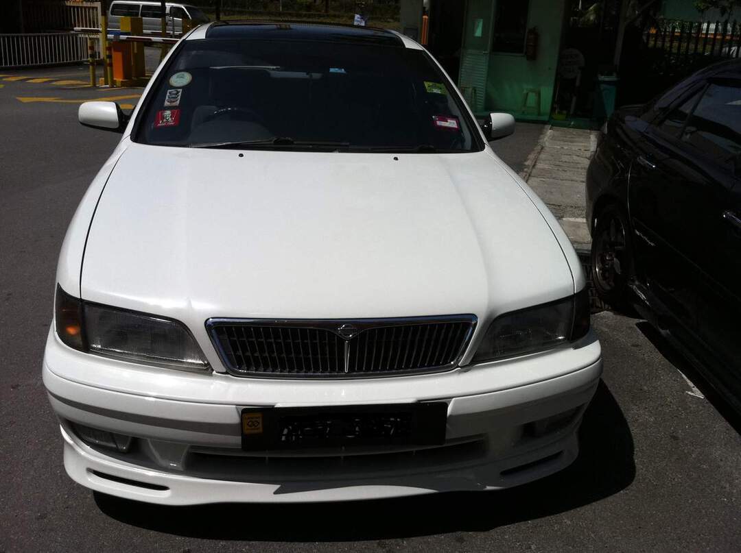

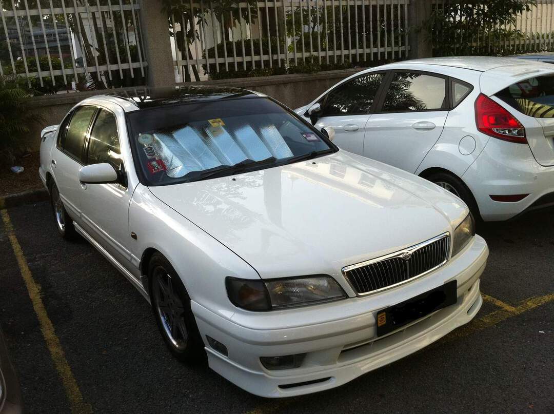

Selling my A32 2.0 for Rm25k nego. Interested just pm me ok?

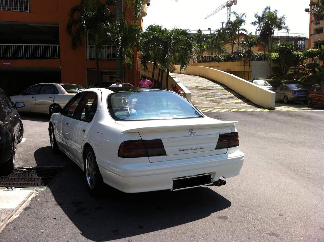

Cefiro badge had a few alphabets missing, so I replaced it with skyline emblem, hehehe..
