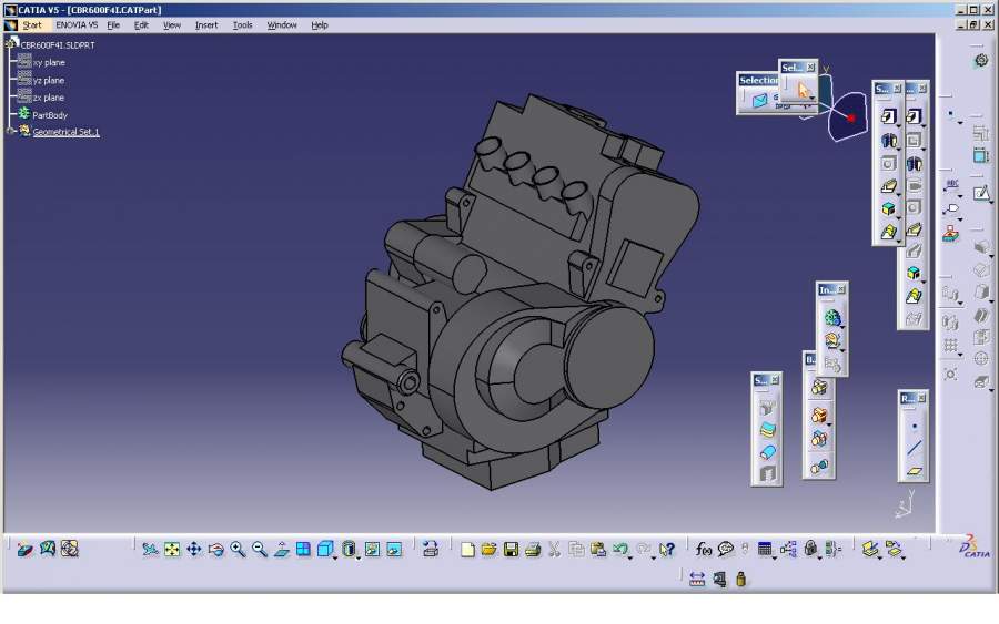

I've just decided the engine model to be used and obtained its CAD file with rough drawing and precise chassis pick up points. :rolleyes: A CBR600 F4i engine will be used as i got the dummy engine (i guess the engine is actually in working condition, but i never fired it up) at home, yet it is bloody cheap:biggrin: , is worth to invest.
Currently at a stage where suspension system design must be done before design chassis, load things to understand like wishbone, damper, spring rate, anti roll bar, hubs, tyre bla bla bla..... and their effects on vehicle dynamic. This is really disaster.
Wheel size and some tyre data must be in hand to investigate the theoretical limit of tyre in order to start design suspension layout and hubs which can hit the limit of tyre at max lateral acceleration of vehicle. Now thinking where i can get those data of popular tyres used in FSAE, i know uni got some.....some other teams also got....but don't think they will generously give me as they paid for the data.:smokin:
will update soon if there is progress:wavey:
this is the CAD model of CBR600 F4i, weighs about 70kg

nice drawing you have there. Are you in engineering field too.
looking forward into engineering field....currently still looking for job...unfortunately redundancy and eco crisis occurred when i graduated.....

bro.. how to use the application? been wanting to learn.. but dont have the chance since not the same field..

I would suggest you get started with complete tutorial, software(easily obtained from...i guess you know, otherwise pm me), then do what the tutorial does,you can also get some ideas from youtube or any related websites. Usually start with simple tutorial, then draw something simple, try to get the idea how stuff can be modeled, usually there are various of way to model a stuff, like from seremban to kl, you can take highway or old road or maybe you can go to johor first then go down to kl, so of course the fastest and simplest way is the best usually. Hope this little info can help you.:biggrin:

t51r, have u done the suspension parts?
what software did you used to run a simulation?
did you modeled the F4i engine in catia by yourself?

Yeah, I use Catia V5. I should have modeled the engine, however there are CAD file of that engine out there, so I don't want to waste time to model it.

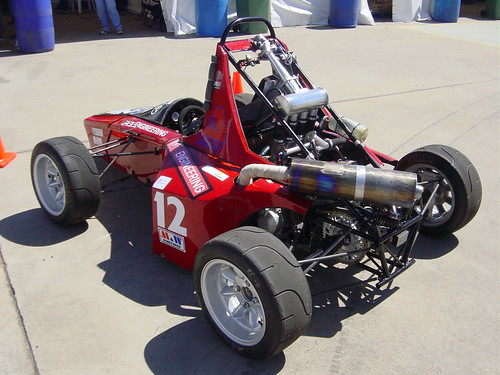

some eye candy to get the juices flowing

anyway... some details of the UTS 2005 car you see below..
chromemoly space frame with semi stressed engine..
race weight : 240 kilos plus driver full tank petrol and liquids
yamaha r6 engine running sequential injection Motec M800, M&W CDI
custom manifold and extractors, exhaust
110hp@wheels through 20mm restrictor and BP 97 pump gas
0-100 in 3.2 seconds
max lateral G is 1.6 with Avon slicks
that year we managed 12th place out of 30 entries..
an excellent achievement considering we had 15k AUD to build the car..
UWA that won that year had 100K...
but that aside.. most of the guys that build these cars end up with motorsports jobs...
the suspension guy on my team now works for Williams F1..
the guys on the winning teams are in F1, F3, WRC and V8 supercar..
so the rewards are well worth it..
