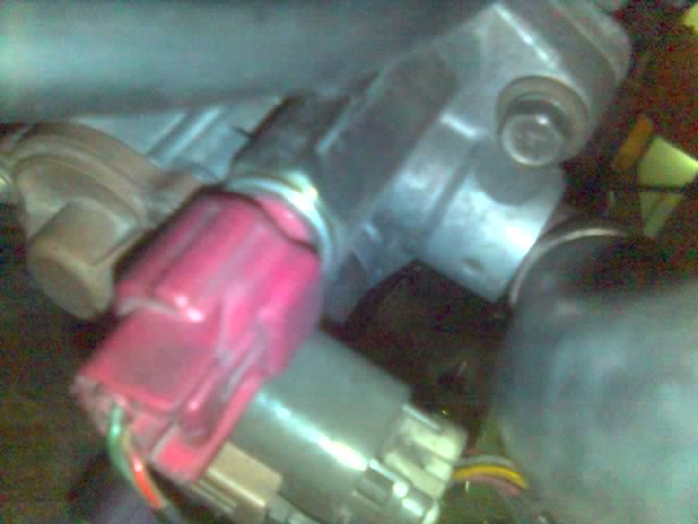

I would place my bet on injectors . Clean your injectors not with injector cleaner but leave it to the pros eg: ultrasound cleaning. Also check your TPS coz if u could go s'pore with
your car i suppose the vibration only happens during idling or slow speed, right? Certain part of the resistor on your potentiometer (TPS) could have worn out, as such the tps could not send the signal to the ECU to provide accurate spark timing and fuel.
it is directly attached to the throttle body . it come with 2 connectors wires with six pins of which 2 pins for power , 2 pins for signal and 2 pins for ground. One of the connector is linked to the auto trans ecu (changes gear after receiving signal from tps).
The tps however could be adjusted slightly if your idle is out of range ( by a pro. technician). If adjustment does not relief or help the rough idle or slow speed, the unit needs to be replaced and adjusted again accordingly.

Does TPS affects rough idling or cause vibration, as i know it will affect idling range (too high or too low). I have checked its voltage at closed Throttle and full throttle position, it is within the range (0.4 and 3.96).

The Throttle position sensor (TPS) as in the name detects the angle of the throttle position and sends a signal to the ecu to provide optimum fuel and spark to the engine. Say, if the tps sends the wrg signal to the ecu , it wont be able to accurately provide fuel/spark for combustion. I suppose the reason why it causes rough idling/vibration during idling or slow speed is because most of the time the needle/ resistor inside the tps would point at idling or slow speed position . Overtime there would be less contact between the needle/resistor and the wall of the tps. This will somehow prevent the tps to send the signal to the ecu at idling or slow speed position.
We cannot adjust the timing on the VQ engines, hence its electronically controlled.
Note: You can just borrow from other felio members who have spare throttle body (incl. the tps) and swap to your engine and see whether it solves your idling problem before considering replacing it with a new unit. Let me know if it works. Thanks..
