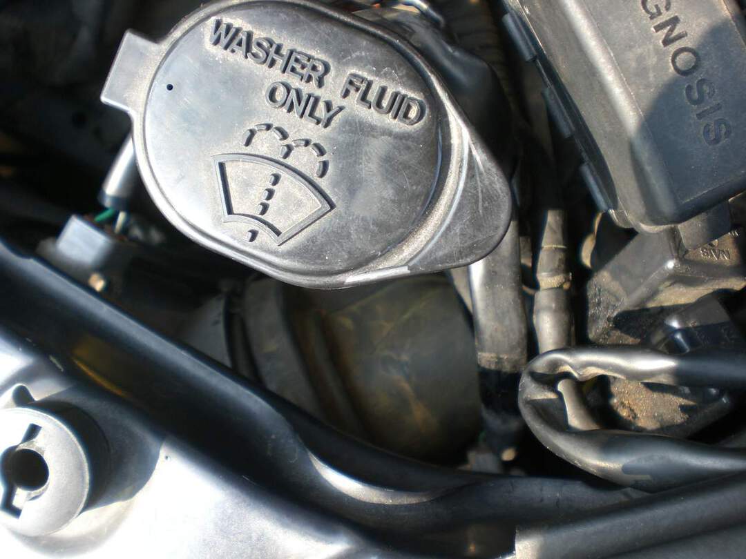

there's lot of wire behind the bulb cover...difficult to reach...is my wiring condition is not normal?
push the wire away and take out the bulb lo.. cant ma? i just remove the my hid bulb 2day.. coz burned already.. easy job.
