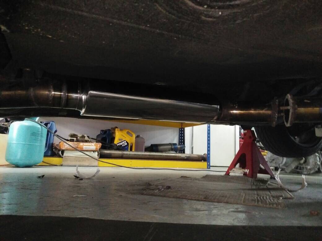

Reduced 20-30% overall noise. Hard to do when the whole exhaust setup is 4" front to back.

4 inch..a kitten or mouse can easily got lost in there.

To custom weld and shave the turbo inlet / outlet ports, install, reduce downpipe size, injectors and install the muffler all in with custom welding and all RM750. It's quite ok considering the amount of work needed and all.
wah.... including material? nice nice.

Yeah. I provided the tabung, turbo and injectors. The rest was the fabricator. Recommended by the Bimmers original owner. My only issue is I can't speak malay well so conversing with the guy is a problem for me.
